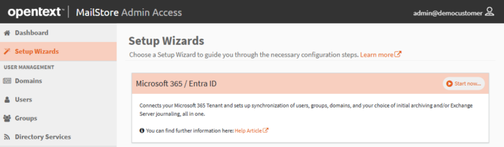

MailStore Cloud also offers Setup Wizards, which you can find under the “Setup Wizards” item in the side menu. Choose the Microsoft 365 / Entra ID Wizard from the avalable entries, which guides you through this whole process interactively, and creates configurations and schedules as well as the journal mailbox and endpoint for you automatically.

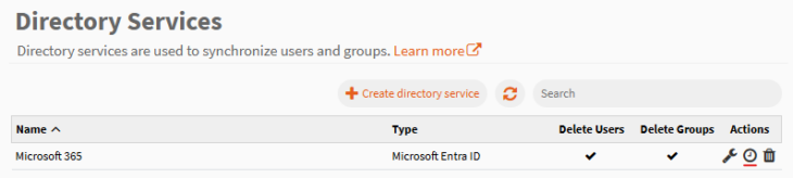

Create a Schedule to run the Directory Service Synchronization
To create a Schedule to run the Directory Service Synchronization:
  1. In the Directory Services tab, select the clock icon under Actions on the previously created directory service configuration.
    1. Select the recurrence for the schedule. Note: the directory service synchronization should be executed periodically.
    2. Save the configuration.
  2. The schedule should now be executed at your selected timeframe. A log for the execution can be found in the Process Log tab in Compliance.

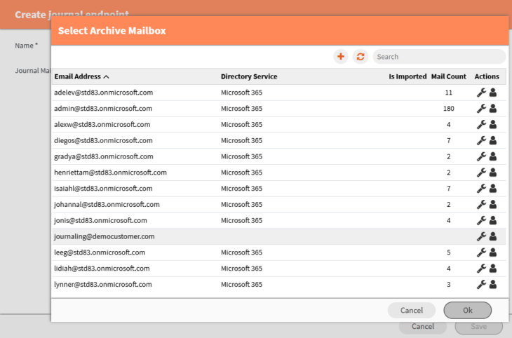

To create a Journaling endpoint:
    1. Navigate to the Journal Endpoints tab in the Archiving section.
    2. Select Add journal endpoints.
    3. Enter a name in the Name text field.
    4. Select a journaling mailbox. Note: You should create a new mailbox in MailStore cloud that is only used for journaling.
    5. If not done so already, a new mailbox can be created directly from the Select Mailbox dialog by clicking the +
    6. The journal endpoint dialog should now look like this:

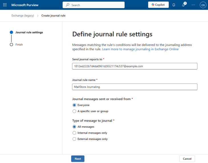

Select Save. The confirmation will stay open and show a “SMTP address” entry that can be copied. This is used later in the Microsoft 365 configuration to setup email journaling:
  1. Sign in to the Microsoft 365 Purview portal as an Exchange or Global Administrator for your Microsoft 365 tenant.
  2. In the left navigation menu select Settings.
  3. In the now shown Settings submenu select Data Lifecycle Management and then select Exchange (legacy) or use this link.
  4. From there, click on Journal rules and then New rule.
  5. In “Send journal reports to” enter the SMTP Address you copied in one of the previous steps.
  6. Enter a name in the Journal rule name text field.
  7. Select a preference for Journal messages sent or received from.
  8. Select a preference for Type of message to journal.
  9. Click Next to review and submit the configuration in the next step.
Emails sent and received from now on should be redirected and archived automatically to MailStore Cloud. To archive already existing emails, you need to configure Mailbox archiving and run it once.

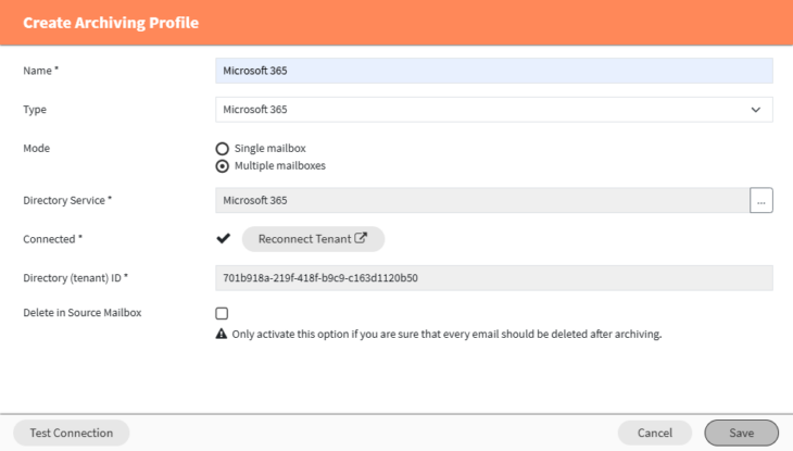

Create an Archiving Profile
This step can be skipped if the “Create archiving and folder synchronization configuration” checkbox was checked during one of the steps in the prior section “Continue creating a Directory Service Configuration”, because then an archiving profile was already created.
To create an Archiving profile:
  1. Navigate to Archiving Profiles in the Archiving section.
  2. Select Add archiving profile.
  3. Enter a name in the required Name text field.
  4. Select Microsoft 365 in the Type dropdown menu.
  5. For the mode, select Multiple mailboxes.
  6. Select the directory service that was setup in the prior section: Start creating a Directory Service Configuration in MailStore Cloud.
  7. The Tenant ID is taken over automatically from the selected directory service configuration, and the connection is automatically re-tested.
  8. Choose the filter appropriate for your use case, e.g. messages of the last ten years, or leave it empty.
  9. Click Save.

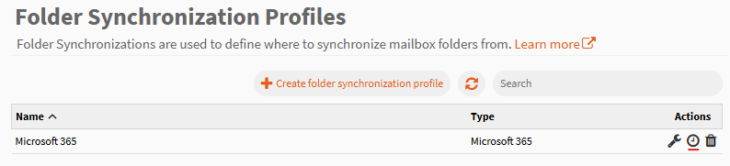

Create a Schedule to run the Folder Synchronization
  1. In the Folder Synchronizations list, click on the clock icon on the previously created foldersync configuration.
  2. Select the recurrence. The folder synchronization should be executed periodically.
  3. Save the configuration.

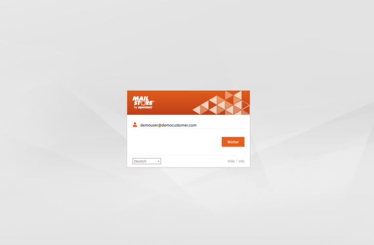

Log in to Web Access
You should now be able to log in to Web Access with any of your synchronized users (from your synchronized domain).
